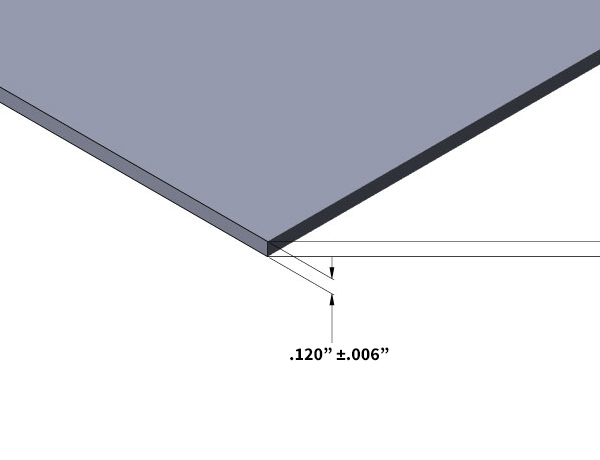

What is material thickness tolerance?
A material thickness tolerance is the allowable variation between a material's nominal thickness and its actual measured thickness. Because we work to nominal thicknesses, the material you receive will vary slightly from the figure on the spec sheet.
Why it matters at the design stage
Choosing material thickness is usually one of the first steps a designer takes when starting a project. Proper tolerances ensure that parts fit together seamlessly, which is especially important for assemblies.
Don't forget finish tolerances
Adding a finish such as powder coat increases the overall thickness, and this should be factored into your design from the beginning.
Cold Rolled Steel Specified Thickness Tolerance
11 Gauge 0.120" | 3.05 mm ± 0.006" | 0.15mm
12 Gauge 0.105" | 2.67 mm ± 0.006" | 0.15mm
13 Gauge 0.090" | 2.29 mm ± 0.005" | 0.13mm
14 Gauge 0.075" | 1.91 mm ± 0.005" | 0.13mm
16 Gauge 0.060" | 1.52 mm ± 0.005" | 0.13mm
18 Gauge 0.048" | 1.22 mm ± 0.004" | 0.10mm
20 Gauge 0.036" | 0.91 mm ± 0.003" | 0.08mm
22 Gauge 0.030" | 0.76 mm ± 0.003" | 0.08mm
