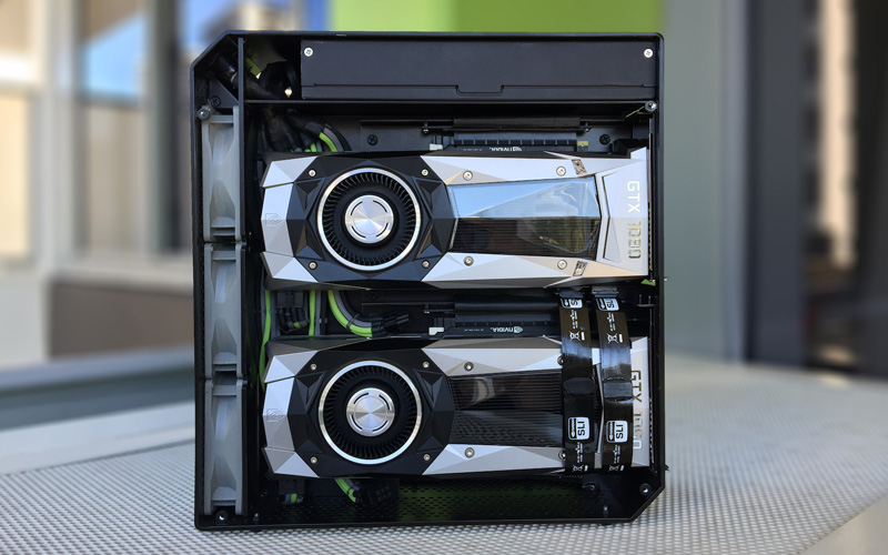

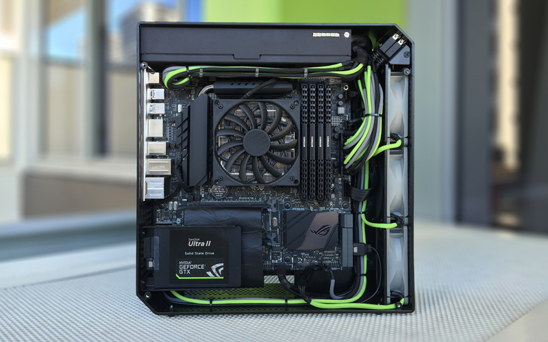

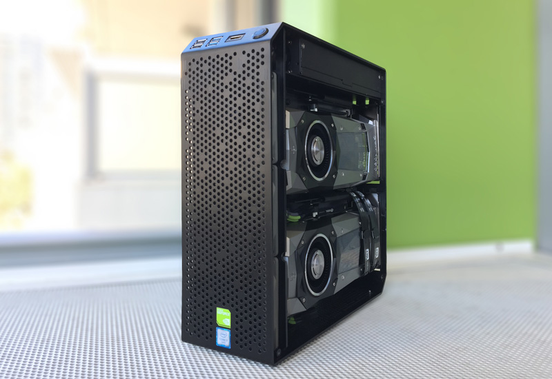

The case is designed so that the 2 hottest components in the case, the CPU and graphics cards (see technical specifications below), are separated and have access to fresh air directly from outside the case. As you can see from the photos below, the CPU is accessing fresh air from the left side of the case, and the dual graphics cards are accessing fresh air from the right side of the case.
A fully finished custom computer case by Lukasz Dyjakon

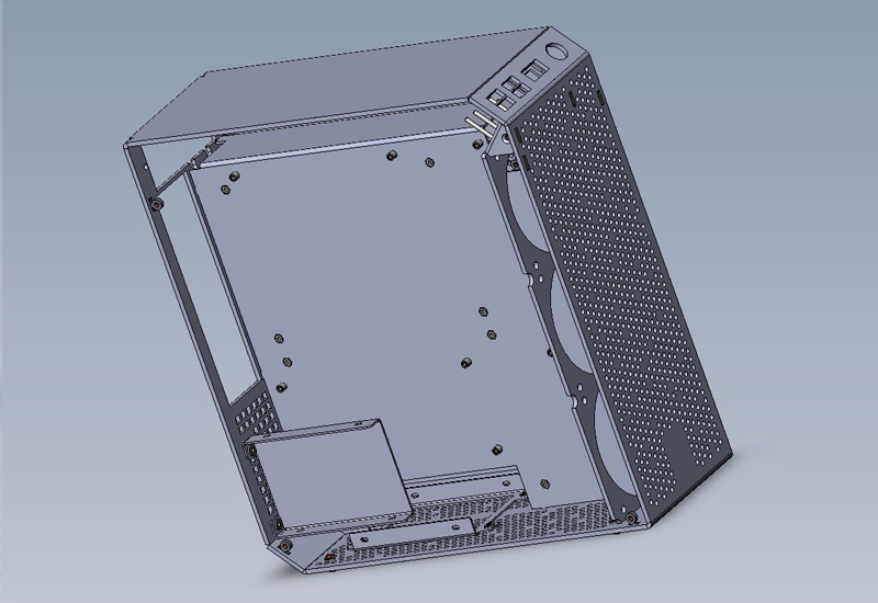

A 3D render of the custom computer case
Left side of custom case (CPU)
Right side of custom case (graphics cards)
Dyjakon was able to test the temperature and performance of the system and has indicated that "the results were excellent... The high end computer components I've put in the case behaved as if they weren't in the case at all, which is simply amazing." The way the case is designed, and with the orientation of the fans, this allows for the hardware components inside to take advantage of the cool air current that is being created.

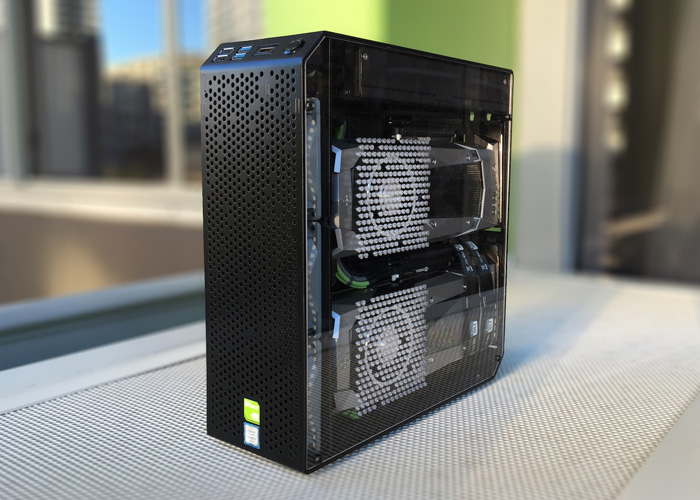

By sending in some sketches of his PC components for specs and dimensions, Protocase's Engineering and Design Services team member John Lord was able to assist Dyjakon with a proper case design for the prototype enclosure based on his specific cooling requirements. Dyjakon was able to get his custom case ventilated with custom cutouts, and powder coated to give it a professional-grade look. Since high-end computer components today are also designed with looks in mind, Protocase also fabricated the acrylic panels that are in place to showcase the internals on both the left and right sides.
These panels also include small custom ventilation cutouts to assist with the cooling of the case.
